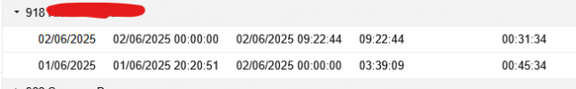

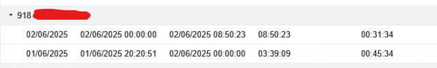

I have some extensions that only access 3CX via hot desk phones only.
The agent log in report isnt showing data for a particular extension for anything before this month.
This report was for "This year"
Here is the call report showing him logging in
and logging out
