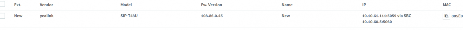

Sorry - lets go with Amazon - installed 3cx and went through the motions - all firewalls pass, no Sip alg etc. Can make and receive calls via soft phones after entering correct rules.
Factory defaulted Yealink T43U, logged into the phone via web - added mac address to 3cx and tried Stun Lan and sbc options. Phone does not provision. Tried manual provision just get provision failed.

Seems to be the network. Voip cannot configure on PC subnet and I cant put a pc on the Voip subnet, so my network is the issue. I would have thought using stun would work but doesn't onsite. I can take the phone off this network and it will provision for Amazon or 3cx but not for onsite PBX.

It sounds like your VLAN does not have internet access, NTP or DNS. If one of these fails the phone will have trouble getting provisioned.

Understood. It sounds like you will have to do some work in first demystifying and documenting the current network, then working your way through a new VLAN that will allow the phones the acces they need (DHCP / DNS / NTP / Internet).
As it is currently, SBC and STUN will 100% fail from the get go because the phone cannot even provision itself. And even if you provisioned a phone off-site then brought it back in, it would fail to register.
Don't waste your time troubleshooting the phones/PBX for now, try to focus on building a VLAN that provides what I mentioned earlier. Once this is ready, you can drop an SBC in that network and see if it will connect to 3CX. Once that is done, you can start resetting phones and they should appear in your management console Phones page. You can now assign them and they should begin to work as expected
