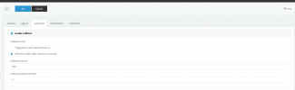

There is a configuration for the call backup under the queues settings Advanced tab
In my case the "Callback Outbound Prefix" is blank. Must I input something like 9 as in your example or it should work with the blank?
You need a prefix 9 to work, then create an outbound rule with prefixes of 9 and strip 1 digit.
