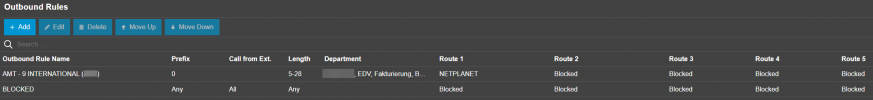

can you screenshot the complete rules list, just blank anything private
The BLOCKED Rule has no routes, that means, that it wouldn´t get ti NETPLANET SIP right?
One other thing I found now is this, don´t know if this is relevant:
If it's not in the outbound rule list, its automatically blocked, there's no need to create one specifically for it.
