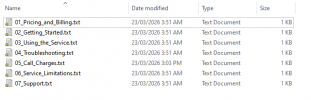

Im currently using 7 txt files and here is an example of the formatting and size of each file.
your feedback on how to make this more efficient is helpful.
If the knowledge files represent different content categories, then splitting them can benefit speed - the description you give the base is the index whereby the AI searches to find relevant knowledge - by splitting and describing what's in each one you help it home-in to the right data faster, and also minimises "cross-talk".
