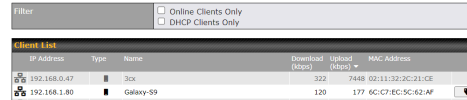

So a user just experienced issues. I checked system resources on the NAS and on the 3cx installation and nothing was strained. It's running 3 dedicated cores and 8 GB ram.
However, I did catch the 3cx device doing an upload during this time. This significant upload would explain the issue since the internet connection is capped at 10MB.1679668516329.png
I can't find what would cause this. Any ideas? Not a backup as that is set at night.
Unfortunately I can't view this. View attachment 34802
