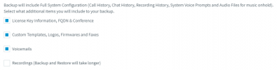

To start I'd say you'd need to take a backup on the old machine selecting everything except your recordings. Schedule this during downtime as it may take a bit. Save the backup off of the old machine. Power it down (don't delete it).
Now install the new machine using the backup. Power up the old machine and copy the Recordings. Place them where you want. Now point the Management Console to the recordings.

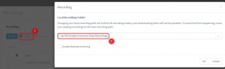

Hi @SystemWise,
The backup will include the original location's path. Once you follow the steps laid out above, change the path to where you'd like the PBX to find the files and it will continue with that path in future backups.
