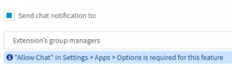

If you're worried about the other supervisors missing the call as they're on a call already, you could look at using emergency numbers (and assign a false number instead of a real one) to send them a message. I did this by creating a bogus SIP Trunk that won't register, then assigning the Emergency Number route to that trunk and having notifications sent to Extention's group managers:
I set the extensions themselves as managers and they receive a chat notification saying "EMERGENCY". It's another options if you'd like it.
@VasilisV_3CX From we can enable this option?
Is this only enable in V18?
Hi @Rashid Raza,
This option is in both V16 and V18, you can find Emergency numbers under Settings >> General, then scroll to the bottom.
