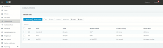

Good morning, so that looks like on the screenshot, or should I remove the DID rule? Unfortunately, I can't test it at the moment.

The recommendation was to enter 0031* and that screenshot does look like 0031* . Ultimately testing (and entering so it's matching whatever is coming it) is going to be how you know it works.
