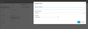

Is there no method with the call forwarding into user settings and the exception option with caller id ?
You can set the exception to an extension but note that you need to route all calls to this extension:
@FREEEEMAN I am not familiar with the different options available with the different 3CX accounts, but as @TheodorosG_3CX has said, I think if you are sending all of the calls through one extension (dummy extension or real extension) then you could create an exception for that one inbound number and send it to another extension.
