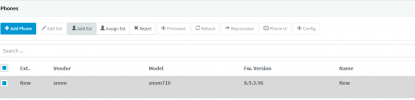

I have noticed lately that provisioning our Snom phones via Plug’n’Play isn't working. The phone shows in bold and as new on the phone tab, you select it and choose assign extension, set all parameters and hit ok but the phone is never provisioned.

it shows on the phone dashboard, but it doesnt do anything once i assign the extension.
