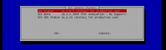

You are right, the ISO we link to from the SBC guide currently is still the Debian 9 ISO, but you can go the the V18 Beta blog post and grab the Debian 10 ISO that is for testing 3CX V18 PBX. Once you run it though, in the menu that is presented to you, you will have the option of installing the stable version of the 3CX SBC.
So yes, you will have to scrap the old VM and recreate one, but if you do so using the V18 ISO linked above, you will end up with the SBC on the Debian 10, using the 3CX ISO.
