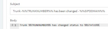

Are you referring to this email notification:
If yes, do you mean you're receiving a lot of notifications? If yes I'm not sure what you mean by "triggering too frequent alerts", it will trigger as many as needed depending on how frequently the SBC connection is dropping so if this is the case, I suggest looking into why the SBC connections are dropping.

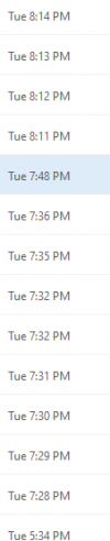

So glad to see your post about this. This alert is the only one I care about because it usually means either my phones are down or not (typically because our internet or power went down at the office). I got 26 emails on Tuesday in a somewhat short timespan and ALL of them said the status changed to up. Rather than alternating between down and up. So what, the status changed from up to up? Great, thanks for wasting my time.

Hi Steve, yes rhetorical. But if you look at my attachment you can see that many of these email alerts were literally only 1 minute apart. If your theory is correct about packet loss/connectivty etc, that's fine. But I believe it should be reporting a different notification. For a trunk/sbc alert I would really only want to know when the status is changed from the last reported status.
Right, so it was dropping and reconnecting that often. The alternative would be, I guess, only alert a maximum of one reconnect every 5 minutes? I'd expect a lot of "my trunk never went down but I can't make calls" posts. At least this way the admin has some idea there's a problem. It's a point of view and I'm not trying to argue with you. I guess I see it as a benefit, though a bit confusing until one understands why "down" emails aren't always sent.
