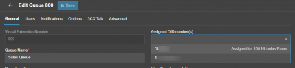

I am not finding this while searching so thought I'd ask. We upgraded a server from v18 to v20u3. It had a DID rule sending to the system voicemail extension 999.
If I start to create an IVR I can see the DID is still assigned, and in fact it works if dialed:
However, for knowledge purposes, how does one set that now, in v20? I found https://www.3cx.com/community/threads/v20-system-extensions-inbound-rules-dids.127448/ which suggests using an IVR that plays a prompt to press 999, but it apparently can't forward to a system extension. Is that the only/correct way now?
If I start to assign that DID to something else, it will be removed from 999 so I guess that's how to remove it.

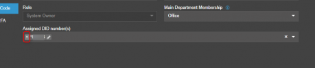

You can assign a DID to any destination just by going to that destination and assigning the DID. If the DID is assigned somewhere else, it will transfer it to the new destination.
To remove a DID from a destination, just click the X button next to the DID where it is assigned.
