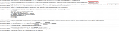

Attached are all the screenshots of Trunk setting, Route settings, user settings.
Logs keep saying 'reason rejected + no_access', reason rejected + no_route'
Country (USA) is also whitelisted, routes properlyt set yet not able make calls.

From logs, it seems request is not hitting to provider even from 3cx, as 3cx is it self rejecting, saying no_access, no_route.

Can you check if there is anything reported in the Event Log? Also if possible set to Debug logging and repeat so we can see as much detail as possible.
Attached the Verbose log for a failed call.
Is the voxbeam Trunk up/green?
Is your routing/internal DNS set correctly? I see the system talking with it's internal IP, but nothing popping up with the public IP for the PBX or the trunk endpoint.

I believe something changed with your public IP on the 29th. Perhaps your SIP provider needs to whitelist the new one?
