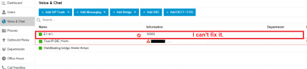

Hello.
I After Updates 3CX V18 to V20.OS upgrade to Debian 12
I can't fix the Sip trunk.I don't know why.Before, I used 3cx V.18 OS Debian 10 and could use it normally.
I will insert the image where the problem occurred.
Is there anyone who can make suggestions? And can you help me?
thank you

Hi there.
Are you able to export this trunk? What template is it used in there?
I can't export data.
But I captured the old setup.
  • E2.pdf
    E2.pdf
Hi there.
You could use those posts: 1 , 2 as well as doc that explains about each SIP filed parameter, to create a Generic template and then import it to the trunk.
So you will create a Generic trunk, export the settings, adjust it and then import it to the system. Before importing it, remove the existing one.
