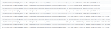

Any info in the activity log to indicate what is happening.
You may have to increase the logging to Meduim or Verbose. Within Activity Log , click on the setttings icon on the right
I see a lot of certificate validation errors, my guess is I should speak to Aatrox again?

Hi @Kriath
Aatrox Communications for Australia is not supported for TLS so I would recommend switching back to UDP and trying again.
