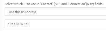

In any case, try creating a Generic SIP Trunk and then try these settings:
In the options tab set the contact ip as follows:

Thank you @ChrisC_3CX !
Based on your info I have been able to configure (more or less correct the) trunk and now I am able to receive calls from outside.

HEllo @ChrisC_3CX Hello @YiannisH_3CX ! thank you for your support ! I have been able to register correctly trunk from RCS-RDS .
I have added that 2 static routes and because I was not able to make system to resolve name of sip.rcs-rds.ro I have added it like a "red neck" in /etc/hosts
