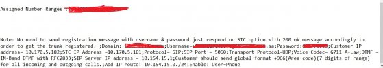

We have contacted STC and kindly find my below notes:
  • They informed us that the trunk should be peer trunk.
  • Attached is Email from STC with the required setup information.
  • Attached also is 3CX SIP configuration based on email from STC.
The call didn't established . Below is Activity log:

Thx for the great document . What i understand that source identification is used to check the source of INVITE message to be sure it is from trusted domain . In spite that fact that our VOIP provider shared with us username & password , He shared with us the below information also:
"Note: No need to send registration message with username & password just respond on STC option with 200 ok message accordingly in order to get the trunk registered."
So does source identification is required in my case ?
Best Regards
Correct, in your case it is not requested.
