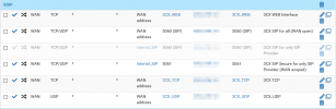

The firewall we use is Pfsense 2.5.2 and the used NAT rules are these:
As you can see I have two NAT rules for either any incoming allowed on port 5060 TCP/UDP and one scoped for my SIP trunk provider (+ 3CX).
The latter is main rule and the first is mainly used for testing in case of issues (like this occasion).

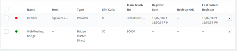

Yet it still won't register:

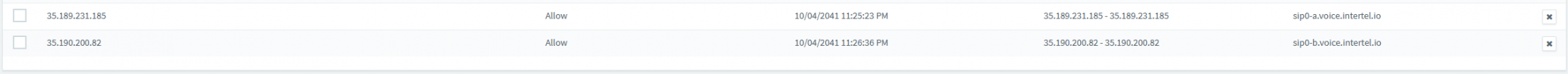

After long searching I have found the issue...
It was caused by the PBX itself, it blocked the SIP trunk IPs due to too many failed authentications. Hence you get the DNS error message, unfortunately without the mention of a block.
As a precaution I've whitelisted the IPs.
