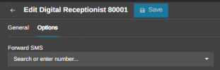

Regarding incoming SMS routing, please note that while SMS is not handled in the same way as voice calls, you can achieve your desired behavior using a Digital Receptionist (IVR).
For this, navigate to Admin > Call Handling and create a new IVR. Assign your desired DID to it for you to manage the calls as you like. Once done, under the Options tab, you will find the 'Forward SMS' setting, where you can select the desired extension, such as a Ring Group, for the SMS to be redirected accordingly to multiple users.
