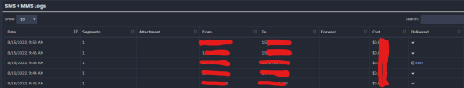

I am also on this update for our DEMO System. I have confirmed Skyetel SMS logs have seen the inbound message, but I am not receiving in 3CX. Outbound seems to work instantaneously.

If you have access to the Tenant or Provider portal, you can see these under SMS + MMS Logs. Skyetel shows the "inbound to 3cx" sms was delivered, but it never shows up on 3CX Side.
