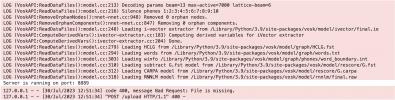

Hello everyone,
I want to use Speech to Text in 3CX Call Flow Designer. I'm already using VOSK with a Python script, which works with manual upload through an HTML form with a WAV file. However, unfortunately, the Call Flow Designer is unable to upload the WAV file. The call flow should only continue when certain words like "Hello" are recognized. Google Cloud and Amazon Polly are not options for me; I prefer not to use these services as I want to use my own TTS system with VOSK. Does anyone have an idea of how I can implement this in the Call Flow Designer?
I have already added the HTTP Request component, but I believe the content type in the code line is incorrect. I am also unsure if I need to add anything in the header of the HTTP Request component.
I would be happy to attach some screenshots of the current content of the call flows.

You will need to use a C# script to upload the WAV file as content body. The HTTP requests component is designed to send text, not binary data.
Ok, do you have a C Script for me?
Thanks very much. I will test it later and will report.
It is currently possible for my Python script to start recording. However, Vosk does not yet recognize all the words. I probably need to train the language model.
