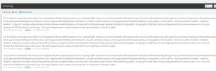

since following last three days I got a failure on 2 pbxs LE Cert renewal with that kind of message:
The SSL Certificate renewal for fqdn.on3cx.fr failed - Error:
IpUpdater.FqdnGenerationException: Error creating FQDN: Unknown error
at PostInstall.CertificateGenerator.ProcessCertificatesDirectory(String directory, Boolean temporaryCertificateGenerated, Int32 regenerateNotSelfSignedCertificatesFrom, Int32 regenerateNotSelfSignedCertificatesTo, CloudServerStatus statuses, Int32 regenerateCertificateExiredInDays, String appBin, UInt16 sipPort, UInt16 tunnelPort, Nullable`1 httpPort, Nullable`1 httpsPort, Boolean isPassiveFailoverMode, Boolean enableDnsHelper)
at PostInstall.CertificateGenerator.RenewCertificates(String appBin, String nginxConfigFolder, String configurationPath)
A communication error occurred between the DNS Servers and LetsEncrypt. This rarely happens and is usually resolved on the second attempt. 3CX will try again.
Is there 3CX / LE process with known problem running actually? Do I have to worry about something?
