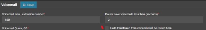

You can turn off transfer from voicemail.
When you turn it off, it will change the voicemail prompt to remove the "or press X for the operator"
System > Voicemail
@AndreIso you may select the users you want and do not need custom prompts,
Edit them and select the language you need ( in this case the custom one ).
Also you may do what Alphabetic metioned above, disable the option to transfer calls to the operator.
