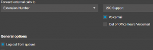

The simplest option is for the agent to switch status to Do Not Disturb
As, by default, it should then log the agent out of the queue so the call wont go to their voicemail
you can also set the DND call to go to a specific extension's voicemail
the option Log out from queues should be active.

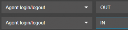

If using DND is not an option, then setup two BLF's as follows:
when logged out agent is still available but won't receive calls from the queue

Hi Keith,
thanks for your reply, we set specific office hours for the employees to overcome the situation and with this setting the extension is set to DND and this state forwards the call to the Hotline-Catcher.
Thank you, best wishes
