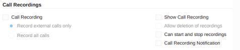

1. Recordings
We tested the call-recordings (earlier this year), and while working fine, I had to disable it because of my company-policy.

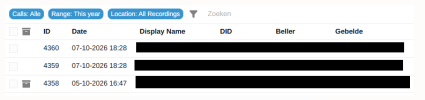

But I still see calls being recorded and showing up in the admin\recordings.
I double and triple-checked everything and I’m sure that recordings are disabled throughout 3CX.

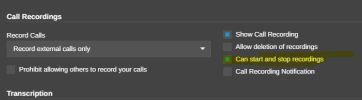

1. Users are still able to toggle recordings on/off. Only in 3CX AI edition can you prevent users doing this. https://www.3cx.com/ordering/pricing/features/

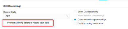

@RonaldVanhove to add on top what @Alphabetic mentioned for the Recordings, in U10 even if in the extensions you have option " Can start and stop recordings " enabled, now you can setup an additional option to Prohibit others to record calls to your extension.
Example is a Manager that does not want internal or any calls to be Recorded and another user tries to recor this call.
With the below option enabled in the Manager 's extension, even if the other side tries to record the call, this will be prohibided.
