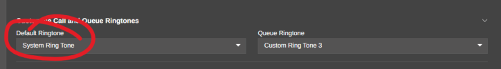

-Now I have the phones set to use "IP phone - customize Call and Queue ringtone" such that we have "systemRingTone" for both the "Default ring tone and the "queue ring tone"
-- drama point now I relaize, is that I think maybe "queue ring tone" has nothing to do with a ring group, ie, ring group is not a queue.

When changing the ringtone of a phone for a specific queue, that ringtone will only play when a call is received to that queue and not a ring group. As you mentioned, ring groups are not the same as a queue, which is why this change does not apply and there is no option to change this.
What can be done is, instead of using a ring group, to use a queue with the ring-all strategy.

Followup note, I realize that my testing yesterday was confounded in part because my config change with queue ring tone preference - I thought was setting managed purely from server side, but I think a re-provision of handset was needed to push those changes out to the phones involved. So .. I am re-doing this testing and will followup to thread, if I can just fix this via the Queue <> set queue to use "system default" instead of "RingTone3" then that should be fine. Even though in this case I prefer how a ring group works over a queue. Just want to get it working. Sigh.

Surely its just as simple case of changing the system ring tone to the same as the queue?
