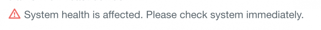

So upgraded one of my instances of 3CX that is being hosted on Google Cloud. Went from V16 to V18 Build 314. When logged into 3CX Portal, all of my other statuses are reporting back green, but for some reason this one instance that is hosted on Google Cloud is reporting Red. When I hover over the the Red Status, it tells me "System Health effected, please check system immediately. If I go to my Google Cloud account, there are no errors there. If I go to the web portal of the hosted account, there are no error messages there. everything is Green and fully functional. Have already restarted the application thinking perhaps it just need a good swift kick, but that didn't resolve it.
Is there something else to try?

Thanks for the reply. Where would the hotel service warning be located on the cloud service? I just went and un-installed the instance from Google Cloud and went to re-install it and as soon as it went to begin the re-install I immediately got the message at the top of the screen under the license #. 1640635698193.png

Thanks for the reply. Where would the hotel service warning be located on the cloud service? I just went and un-installed the instance from Google Cloud and went to re-install it and as soon as it went to begin the re-install I immediately got the message at the top of the screen under the license #. View attachment 26764

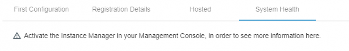

@PatM we have checked this on our side and on multiple installations and we can not replicate it.
In normal terms you should have seen the icon below.
Now when you were on v16, is there any chance to have the IM disabled and then do the upgrade ?
