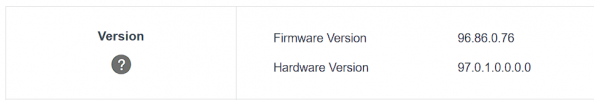

It auto provisioned and pulled all the correct information. In the web interface, I see 'Registering' and nothing happens after that. The green phone line just keeps blinking, and on the phone, it says 'no service,' but it does recognize the extension and the name for the extension, so I know it was able to pull something on the first boot. On the same network, I have the app running on Android, and the web interface up on the PC, and both have no problems, so I don't think it's the network, but who knows. I'm using Unifi for the network (UDM SE). The firmware of the phone is 96.86.0.76. Not sure what else I can provide to help me get this working. Thank you in advance!

There have been a few reports of the .76 firmware not working for a router phone. It has been fine for me but some have posted they had to install .74 firmware. (Change the number on the 3CX download URL)

Downgraded to .74 and now it went from disabled to Register Failed
but at least this time it came up on the screen and tried to do it. Also, after a reboot it comes up as config update and then config skipped. also manually putting in local ip for proxy didn't help.
