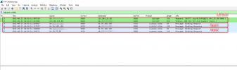

Morning team, I really hope I get assistance, I have been battling with my firewall team with this issue, we are using Sophos hosted firewall and they have confirmed that SIP ALG has been disabled and all ports have been forwarded accordingly and 3CX Firewall checker passes all the services and ports except for these 3 below :
testing 3CX SIP Server... failed (How to resolve?)
I have attached the wireshark results I ran.
I'm using static IP address
I'd appreciate some assistance

Hello NickD, I thank you for the reply.
this is what I can see from the wireshark, hope it gives us an idea of what needs to be fixed3cx3.png3cx3.png3cx4.png3cx4.png
You just proved yourself that port 506 is indeed not configured properly!
This is what a successful capture should look like:
First off, SIP ALG, as you can see the INVITE message being sent, but there is no reply coming back in your screenshot.
Test 1, 3CX sends a STUN request to the STUN Server on IP A, and expects an answer back from IP A.
In your case, this looks successful, from your screenshot, you are sending a packet from xx.xx.22.132:5060 to xx.xx.20.144:3478 and receiving a reply from xx.xx.20.144:3478 to xx.xx.22.132:5060.
Test 2, 3CX sends a STUN request to the STUN Server on IP A, but now expects an answer back from the STUN Server from IP B.
In my screenshots you can clearly see this. In your screenshot, you see 3CX sending 3 request but none coming back.
So, from what I can tell, Firewall Checker is correct.

Hello, and thanks once again, I'm also suspecting the SIP ALG on our Sophos XG firewall. Firewall Checker keeps on failing with detecting SIP ALG!!!!!! even though we have disabled it following the steps below:
Anyone with Sophos firewall, are these the only steps needed to disable SIP ALG on the Sophos firewall?
I think the issue here is not so much that there exists an enabled SIP ALG but that the 3CX PBX is not receiving any replies for the SIP ALG test, that is why the SIP ALG just says "failed" as opposed to "detected". You can also see this from the packet capture as a response to the SIP INVITE sent by the 3CX PBX is never received.
Same goes for the SIP PORT 5060 test, the first test for PORT 5060 that does not require a port or ip change passes, however the second test that requires these to change fails as a response is never received by the PBX. That is the reason it reads "Full cone test failed" as opposed to just "failed".
That said I think you should check the firewall in order to determine if this traffic is indeed reaching it, and if yes, figure out why it is dropping it or not forwarding it to the correct destination.
