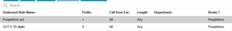

I have a rule to process any outgoing call with "0" and another to process call with "+", both to our SIP trunk. But for some reason the system does not find a suitable rule when dialling with "+"

The outbound rules

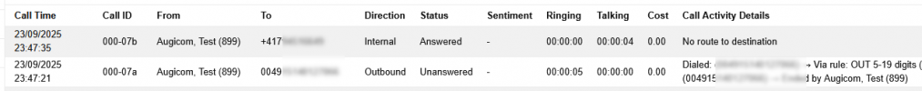

If I call a non Swiss number (say +49 - Germany) it works as expected.
If I call a Swiss number (+41) I get the error

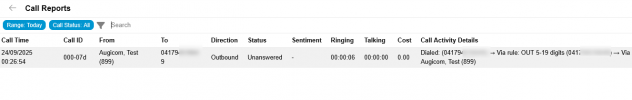

New setup still not working
Now it tries to dial 04179 ...
But this seems to work for all cases
