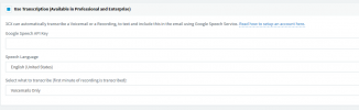

Can we go back to the separate configuration screen for transcription like in V18 where we setup VM transcription with Google (and if that now requires a Google Storage Bucket for just transcription, so be it) and still be able to select SharePoint for recordings not just backups?
V18:
V20:
