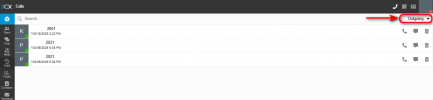

4) As a system owner, where can I see all calls made using the PBX (from all extensions), if I go to calls and filter by Outgoing, actually I can only see my calls.

4. That page you are looking at is just for your personal call log. You would have to go into the admin console and see the call log under reports.
