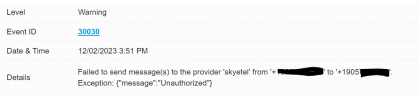

Are you getting any authorization error from Skyetel?
Then you need to contact Skyetel to clarify further.
Skyetel holds the DID but doesn't do SMS on toll free numbers, therefore we are using SMS hosting via Twilio.
If I add the same DID number in 3CX in both the Skyetel trunk and Twilio trunk, it seems to break the call flow for voice calls. SMS works when I add the DID to the Twilio trunk. I am not sure what to do next.
