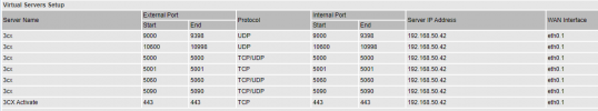

Ports are open on our router as attachment below. The firewall has a green tick, *BUT* fails the full cone NAT tests when run.
Now I suspect our rather complex setup might be the problem. Our Internet access is via a leased fibre shared with another entity, delivered to each of us via a Ubiquiti EdgeRouter 6p - one ethernet port connecting to our router, another to theirs.
So - the question is, do I need to have ports on the EdgeRouter open too? (As in, is that why the full cone NAT tests fail, and correspondingly, why we are having trouble with the Android app and can get no FQDN Access from externally?) I'd be terrified to somehow screw up their settings!! (unsure whether the NAT can be done for one ethernet port on it only, without affecting the other....)
