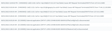

I'll double check that Australia is allowed, below is the activity log:

There doesnt seem to be a call to an aussie number in the snippet you sent.

Thanks Nicholas, I have found the limitation is actually with the SIP Trunk provider having done some checks internally. The previous fax line was ceased and the company has a SOGEA (Single Order Generic Ethernet Access) line with no phone line and they only have capability (with the SIP Trunk provider) to receive faxes which go straight to an e-mail address.
