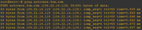

System is self hosted. Not sure what to make of this I can ping from command line activate.3cx.com, but i keep getting this error Unable to reach 3CX License Activation Server. Confirm that your Primary DNS Server is able to resolve activate.3cx.com.
Try putting 8.8.8.8 and 8.8.4.4 in the /etc/resolv.conf file instead. Then reboot the machine and try again.
Reactions: Yellow_Flash
That seemed to work, Thanks
