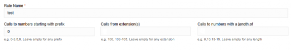

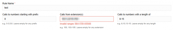

The SIP Trunk that connects the 2 PBXs is a generic sip. I have no restrictions on the outbound rules and adding the '0xxxxxxxxxx' in the allowed extensions doesn't work :

From the screen-picture I can see that you have inserted extentions in the list.
This means that extension that you put here, can dial out via this rule.
This also means that ONLY the extensions mentioned here can use this outbound rule, NOTHING else.
You would like to see calls go from trunk to trunk, but do you have another outbound rule for this ?
Or could you just try to remove the extensions you have here? (you can put them back anytime).
Just try :)
