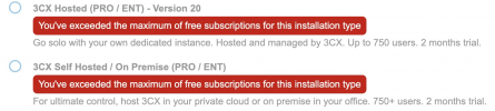

Hi again. I have created a VPS using the marketplace app for 3cx v20 however when I run the URL (port 5015) given at the end of the install we are presented with 'restore' and 'upload a new configuration file from 3CX. No option to do a new fresh install whch is a bit wierd.
All my partner has confirmed is that we cant use our licence key on hosted but should be ok on self hosted.
You can use www.3cx.com/install to generate an XML file for your license.

My login to try and create an xml shows the following and its a PRO in doing:
