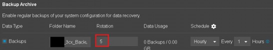

on my 3CX instance the backup rotation is set as below, i did a test all afternoon with a backup each hour, starting from scratch with a new sftp user and a new folder, starting at 1PM, behavior is the same:
on folder side i see always these 2 files, the rotation is only between "0" and 1 but never go more
