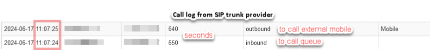

Checking our SIP trunk service provider reveals that we do have calls, as shown in Figure 2. It shows two simultaneous calls: one inbound and one outbound. The inbound call was intended to enter our call queue, but it somehow bypassed all the internal steps within 3CX and was immediately diverted to an external mobile number.
(Figure 2: SIP trunk call log shows we have calls pass through 3CX)

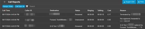

Yes. We set up a test call queue and put every agent into 'unavailable' mode; it penetrated the call queue flow and eventually arrived at mobile forwarding, and it does not have a log entry in admin/reports/call-log.

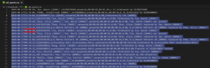

New findings:
We noticed the above happened when the log level was 'Low'.

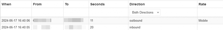

If we switch the log to verbose mode, it does show the last step of forwarding in call-log:
In the SIP trunk log we have the corresponding pattern:
For now, we will leave it in verbose mode for subsequent calls.
