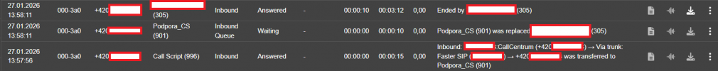

I am sending you a call from the Audit Log for your review.
That log seems to be a working transfer to a single agent. That doesn't show anything wrong. Is that for a call where you experience the issue?
