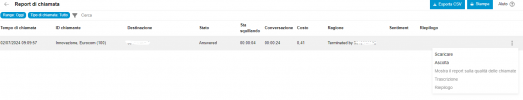

I activated all the integration and I confirm that now in the reports I see correctly the new dedicated space the AI.
I have also activated call logging, in the reports it does not run the summary or all the features with ChatGPT.
I read in the guide that you have to set limits/budgets but they are all paid features.
I wanted to ask you with a free account is it possible to test any features?
Thank you
