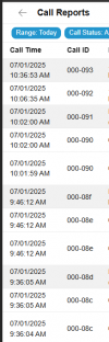

Dears,
i have an on premise installation. With the last update(Version 20.0 Update 6 (Build 724 Release)), i see an issue with the call log. Basically on the call ID i see a GUID value instead of the number.
This is a major issue as i need to generate the report for my customer and cannot send this kind of useless data.
Previous one did not had this issue: Version 20.0 Update 5 (Build 551 Release)
Thank you
Dear @ITSmartwork ,
The updated Call Report allows you to have a much improved view of how a call was processed, and a GUID is the Call ID now, in place of a number. Also individual Inbound and Outbound reports give a more simplified view if needed.
The Call ID is simply an ID field - nothing report wise should depend on its type.
Best,
KS.
oh i see. It's a feature and not a bug :)
thanks!

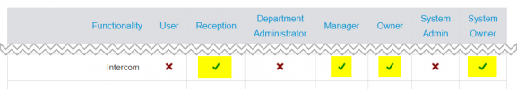

Have a client on V20 U6 (Build 724) that reported that the intercom function wasn't working anymore. Further digging lead me to find that this appears to only affect the department administrator and system administrator roles. Under both of those roles, even though the "call operations" permissions are set properly, the intercom function does not work properly. It will simply ring the extension rather than intercom. As soon as I switch the role to receptionist, manager, owner or system owner, it works perfectly. Surely this is a bug and not by design? Anyone else experiencing this?
Hi @SteveBohn intercom can be used only with these roles: Receptionist, Manager, Owner and System Owner.
If the ext user doesn't have any of those roles, then he can't perform that call action.
So it is not a bug, it has been like that since v20 was launched. Please check this guide for the access roles.
