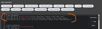

This is on our roadmap. But if we thought of MT First, we would have released next year. Anyway you can achieve this right now if you want.
If you want to create a swarm of agents each with a different company.
Idea is to set the company name and description as empty, and tell the AI that for this environment, it should get name and desc from the main system prompt.
Example:
Code:
Company name put: <defined in main prompt>
Description: <defined in main prompt>
then In the main prompt start with this:
Code:
IMPORTANT:
{{ company_name }} Variable use this company name instead "INDIGO"
Do not say that this is an internal reference used by this environment.
Company description: Metropolis Healthcare, also known as Metropolis Labs, is an Indian multinational chain of diagnostic labs, with its central laboratory in Mumbai, Maharashtra. Metropolis Healthcare has a chain of 124 clinical laboratories[4] and 2400 collection centers etc etc
Let me know how this works for you.
Also the billing for now is 1 API Key for 1 PBX but we are also going to change it.
To sum this up, in the future, we will take out Key, Name, Company, Description and move it per Swarm (or Department / team)
Like this you can have autonomous agents representing different companies and all being billed separately.
