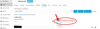

I'm having this issue with a 3CX recently upgraded from V18 to V20 update 2 (installed on-premises):
- Dashboard shows 'unsupported phones'
- On the Users' page, those phones are indicating '(Upgrade)'
- Clicking on that Upgrade issues a (regular) warning about the phone disconnecting
- Pressing 'OK' has no effect at all and phone won't upgrade
Tried rebooting and re-provisioning the phone, but no effect either.
The phone themselves are not accessible from outside the local network per https, only the 3CX but I'd expect the phones getting their updates locally from the 3CX PBX.
Is anybody having the same issue? What's the solution?

Ok:
- I tried the phone-URL (locally) which works
- I performed a local update by downloading the new firmware separately: it worked fine
No factory reset required.
So, the question is why doesn't it work from the 3CX management-GUI? And does anybody else experience this issue?

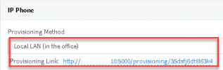

I just checked the phone upgraded manually (by loading the new fw), and the provisioning link is indeed incorrect but points to http port 5000 - strange !

I just checked the config on another V18-PBX and it's also using http://ipaddr:5000 on the local LAN and not FQDNs even though the provisioning links in Parameters (PROVISIONING_LINK_LOCAL_xxx) use FQDNs!! I suppose these links were updated at some point in time, because more recent IP phones use FQDNs, but still http.
I'd make the following assumptions:
- the current provisioning links were generated when setting up new users and connecting the phones for the 1st time (and that was some time ago using v18 before above parameters were changed by some update and before split-DNS),
- I'll have to manually change the provisioning link from http to https on the users' IP phone pane and on the IP phones themselves using the GUI-URL
Correction: the provisioning link on the User's IP Phone pane can only be copied, not edited !! This issue will drive me nuts :mad:

I finally found how to update the provisioning link on the User's IP phone pane:
- Correct the network interface used from IPaddress to FQDN and save
- Re-open and the link is updated to https://fqdn/xxx
DONE :)
