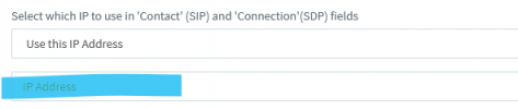

I think I know what is causing your issue.
When you add the trunk using the default template the following value is set in the Options tab.
I suspect that you just switch it to "Use default Settings" without deleting the [Local IP of PBX:5061] which causes the issue as the invalid value is stored in the trunk when you press OK.
If you delete the value before switching it to "Use default Settings" then you will not face the issue. So once you create the trunk just go the option and delete the "[Local IP of PBX:5061]". Then switch the option to "Use default Settings" and then save the trunk.
Let me know if that resolves the problem .

Hello!
Finally I have confirmation - you must remove the content of the box highlighted in blue before switching the dropdown above to "Use Default Settings" and all works as intended.
