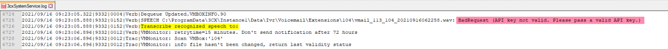

Then the next best thing would be to enable Verbose logging from the Management Console --> Dashboard --> Activity Log --> Settings. Then leave another VMail and say a few words and make sure that you are not using speakerphone or be in a noisy environment.
Now check the 3cxSystemService.log file. You can get this either by generating the SupportInfo files, or by going to the Linux path /var/lib/3cxpbx/Instance1/Data/Logs/ .
In this file, search for "Transcribe recognized speech to:", this will either be followed by the text that was recognized, or be blank if something went amiss.
If something went amiss, on the line right above, there is usually a clue, example here, my API key was wrong:
