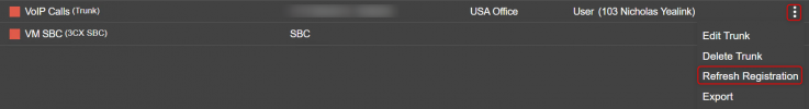

Also, Did you try to refresh the registration from the 3 dots on the right hand side?
I had tried with an invalid username, and I just tried with an invalid password following your comment.
Still no logs in the dashboard, even when refreshing the registration.

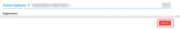

Just go into the subscription and delete the SMB instance from your portal.
I have done that but it seems like some informations are being kept, the instance is re-created as is, and the bug remains.
For instance, the "company name", which then becomes the "department name" can't be changed, the hostname is not regenerated, and the extension range remains the same after deletion followed by recreating the instance, in the same account.
So the option to regenerate all configuration, including hostname, extension range and department name is to also delete the customer's account. This thread can be closed. I hope it can help someone in the future.
